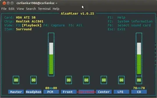

I have already installed GNOME ALSA MIXER on Ubuntu. I did set all the parameters correctly. In Hardware settings, in the "choose a device to configure" section, it appeared as "Built in Audio - 1 Output / 1 input - Analog surround 5.1 output + analog stereo input" because I've selected that "Analog surround 5.1 output + analog stereo input" as the profile.
So the setting may be OK I think. But it only activates 3 channels in my audio system. Front Left, Right and the Sub woofer. Other channels don't work well. Here is the ALSA Mixer in terminal, I can"t volume up those channel from there.
Please give me simple and clear solution for to get this right. Guys please help me.
Try installing the pulseaudio manager and changing the configuration of your soundcard to the desired value:
sudo apt-get install pavucontrol
If that's not working you might want to try and disable all other audio devices (onboard or graphic cards, since hdmi now includes sound, most graphic cards are now also registered as audio devices). If I remember correctly, Ubuntu had some problems recognizing multiple audio-devices and therefore broke some configurations.
