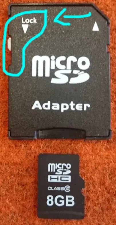

UPD2: I've found a small "lock" switch on my card adapter, and it turns out, that when I insert it in my notebook, it switches on. Perhaps, I have to find some glue or something to get that switch stuck...

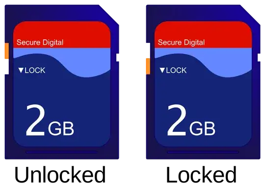

Physical write protection
For those who never used SD cards before (there's a first time for everything, mine was in my late 20's!), you have to move the LOCK switch to the unlocked position:
Image attribution.
It is analogous for a micro SD adapter with a MicroSD inside: the dongle is on the adapter:

I too had this problem. I first noticed it when it wouldn't let me empty the bin. I searched on here for a solution and nothing I tried worked. Then, I noticed on the SD Adapter a little sliding tab which 'locks' the card. Slide that so that it isn't locked. Simple. Never noticed it. After hours of beating my head against a wall, it was a simple mecahnical solution.

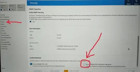

I had this issue, and somehow my Dell laptop BIOS had writing to SD cards disable. Here's the checkbox that must be unchecked in order to write to SD cards via the laptop's built-in microSD card reader Dell BIOS SD card read-only checkbox
