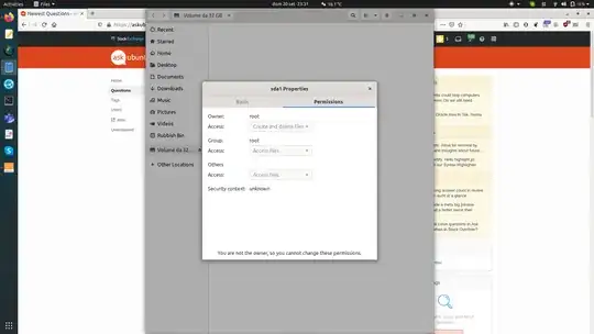

I have problem with a SD card which is Read Only (it's not due to the switch of the card adapter, I've already checked). I format the SD card with 'Disks' but the card results to be as "Read-only" and I can't change the permission see below.
I've tried some commands found online but nothing worked for me (I try these solutions: SD card is read only, MicroSD card is set to Read-only state. How can I write data on it? .) Here's the output of sudo fdkis -l:

EDIT 2: I've tried to do sudo nautilus and then to change owne, group, others and actions of all them, but those changes are not saved since it said "you don't have the permissions necessary to...".
