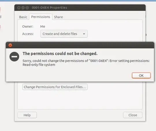

I have tried this solution and it doesnt work.
sudo fdisk -l output is

When apply
sudo mount --options remount,rw /dev/sdb1
says: mount: cannot remount block device /dev/sdb1 read-write, is write-protected
When apply this: sudo chown -hR waqas /dev/sdb1
it shows changing the permission of files and gives the log files but result is nothing when i goto the card and check the permission its the same.
same case with the sudo chmod -R 777 /dev/sdb1
and the last one i apply gksudo nautilus when navigate to the card and try to change the permission it says: enter image description here and window close after a second. So I am not sure what to do.

I just came across the same problem. The reason for the error message is that there is physical switch that prevents a write to the media. You SD adapters have one. But micro sd doesnt.
Solution: (Obvious :P) Flip the switch in the SD card adapter and plug it in.
