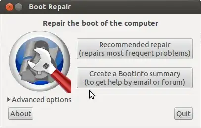

There is another solution:
There is a program called boot-repair which helps in configuring with a GUI.
as you can see from the image. there is a box called Unhide boot menu. Just uncheck the box and press appy. You can access this by clicking on the advanced options arrow.
to install boot repair
sudo add-apt-repository ppa:yannubuntu/boot-repair
sudo apt-get update
sudo apt-get install -y boot-repair
and then run boot-reapir either from the terminal or from the dash.

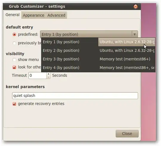

3rd solution:
ou can use an easy to use GUI app called grub-customizer to make your life a little easy. As the name suggests, you can do much more than just reordering Grub menu entries with it.
You can install it by:
sudo add-apt-repository ppa:danielrichter2007/grub-customizer
sudo apt-get update
sudo apt-get install grub-customizer
as you can see from the menu there is show menu option. Unhceck and see if it works
