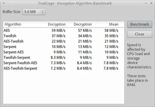

Sometimes programs themselves have a 'benchmark' setting; this is particularly true of the example you give, Truecrypt. The benchmark can be accessed from Tools > benchmark. The benchmark tests how fast your CPU can crunch through the encryption algorithms (see screenshot). The performance of your machine will be vastly increased if your CPU supports AES hardware encryption/decryption. That setting is available from settings > preferences > performance.
