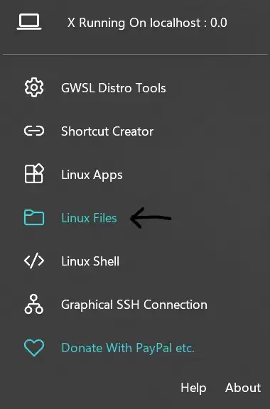

  1. First off you are going to need, GWSL, (aka Windows Subsystem Server for Linux). The GWSL server connects Windows to the Linux distro, and gives access to the Linux file system.
    Below is what the menu should look like when you open it up from the task-view buttons on the right side of the taskbar (assuming you have your taskbar located in its default location at the bottom of your desktop).
  2. Just hit the Linux files button, then select the distro you are using (assuming you have more than one distro to choose from, for 99% of people this will be Ubuntu, or Debian.). If it is the first time I have used the GWSL server in a while, sometimes it will make me select from a 3 menu, where there is another Files option (it didn't pop-up for me this time, so note that its called files something).
