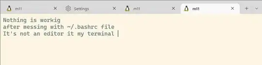

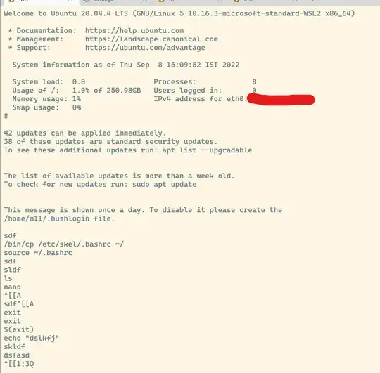

My Terminal Image:
I'm using Ubuntu with WSL and can't access GUI.
Aforementioned images of my terminal, no output is displaying for anything I type. Terminal is acting like an editor. It happened after I edited PS1 variable. I want to revert this action.

Glad you were able to break out of it. In the future, since you are using WSL, keep in mind that you also have the following options for recovering.
From PowerShell, CMD, or the Start menu:
wsl -e bash --norc --noprofile
This will start WSL and execute Bash without processing any startup files such as ~/.bashrc (and others). From there, you can inspect and fix any startup files or other problems. This is typically the best recovery mechanism for this type of problem.
You can even edit your .bashrc directly without starting your shell with:
wsl -d Ubuntu20.04_WSL2 -e editor /home/<username>/.bashrc
Note: The editor command maps to the "preferred editor" on Ubuntu (nano by default). On some other distributions, you may need to specify the editor name itself (e.g. vi). You can change the default editor with sudo update-alternatives --config editor.
Finally:
wsl -u root
This will access WSL as the root user, where you may then edit your user files. Note that if there's an error in /etc/profile (or the .d subdirs) then this still won't work, as the root user will experience the same error. That's why I tend to prefer the --noprofile --norc option.
