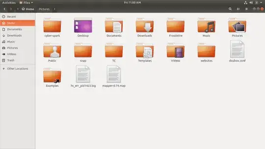

[Note: By default dosbox.conf file is created in the home directory.]

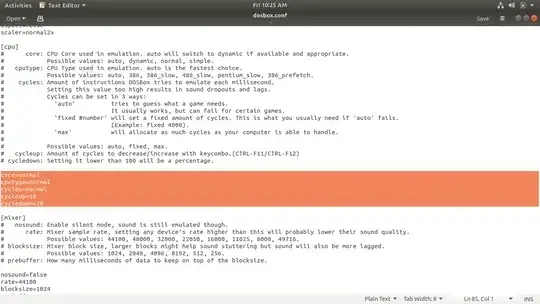

I did this and everything is working fine:
  1. Open "dosbox.conf" present in your home folder.
  2. Change things like this:
    core=normal
    cputype=normal
    cycles=normal
or if you want you can try "simple" instead of "normal", but "normal" works fine.
This is it. Save and Exit "dosbox.confi" and then start your DOSBox again.

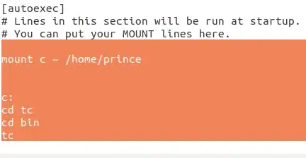

Auto-run Turbo C++
After fixing your problem. Whenever you open DOSBox. Every time you have to mount it and this is a big headache. For solving this follow this:
  • Open "dosbox.confi"
  • Go at the bottom and add these commands for your Turbo C++ auto-run in DOSBox.
    mount c ~ /home/prince
    c:
    cd tc
    cd bin
    tc
and Save & Exit and now run and test it.

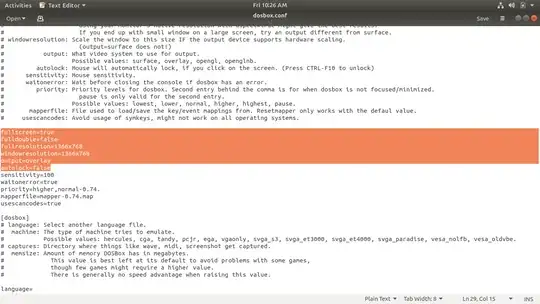

Full screen problem
That is all. It was not in fullscreen mode. That is why I changed this thing:
fullscreen=true
fulldouble=false
fullresolution=your computer resolution
windowresolution=your computer resolution
output=overlay
autolock=false

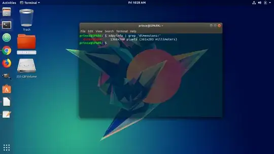

and for finding your computer resolution. Open the terminal and type this:
xdpyinfo | grep 'dimensions:'
