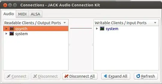

  6. Go back into the JACK Audio Connection Kit window and click Connect, here we are going to make sure in the Audio tab that qsynth is connected to the system output (drag handles).
    connect qsynth to output

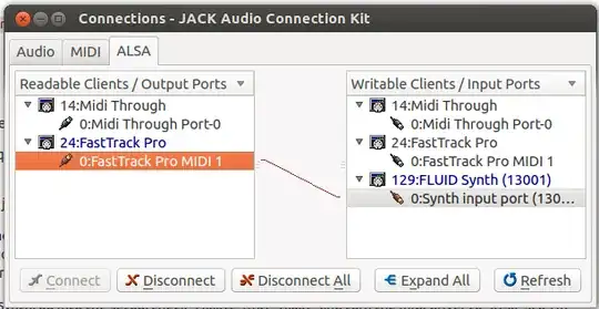

    In the Alsa tab we are going to connect our midi device to qsynth.
    connect midi to qsynth
