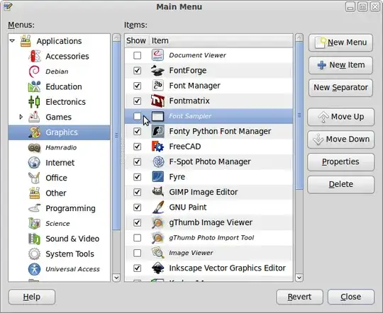

Main menu (alacarte) cannot record changes as it should. Some time it does, but randomly and rarely.
Is this a bug?
This question is not a clone of this one. In that case the Main menu would not open, in this case it does but changes are rarely recorded.
8 Answers8
13
If you want to edit menu entries, the program you want to use is alacarte. Do not waste your time in xml files. Alacarte is the best graphical menu editor for all gtk based menu systems.
sudo apt-get install alacarte
Note/update: alacarte (Main Menu editor) does not work in 12.04 or 12.10 Lubuntu

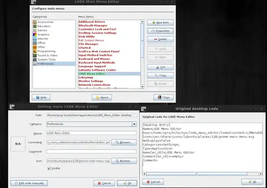

Execute the LXMenuEditor.jar file (Java needed), and then use the program to add the same file to the main menu... (with no spaces in the path...)
  • Java based
  • Cannot edit the main categories (as alacarte would if it worked)
  • Can open and edit .desktop files as text
On youtube
  • Menulibre (as vasa1 suggested in a comment) is a good solution, as it is available for Quantal 12.10 (it was not at the time of the question). See this and this answer. But, just like LXMenuEditor (and unlike Alacarte), it cannot create/edit main categories.
  • Considering Alacarte in Lubuntu: it deserves a try as far as it can edit/create main categories, but it's actions are indeed only randomly possible in 12.10 , and, as far as I can tell, it doesn't work at all in 12.04. It has to be regarded at this point (version 0.13.2-2ubuntu4) as unsuitable for LXDE/Lubuntu (as it is made for Gnome). Please comment here if this is not the case or if it changes in a new version. For a reason on why it does not work, see this answer.
