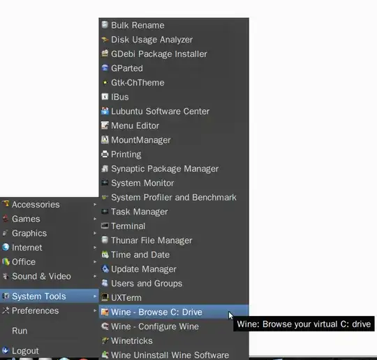

Wine is installed but not visible in the menu.

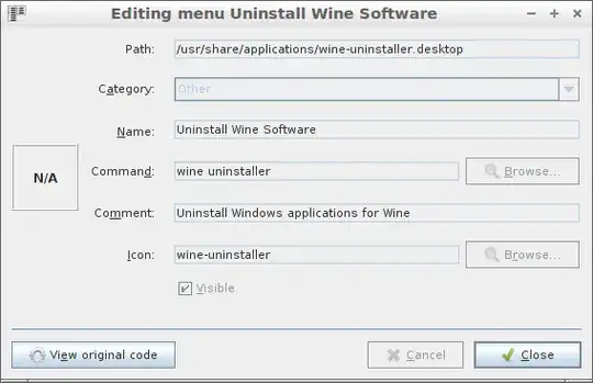

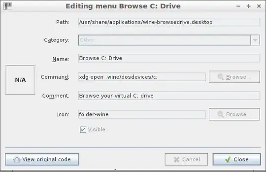

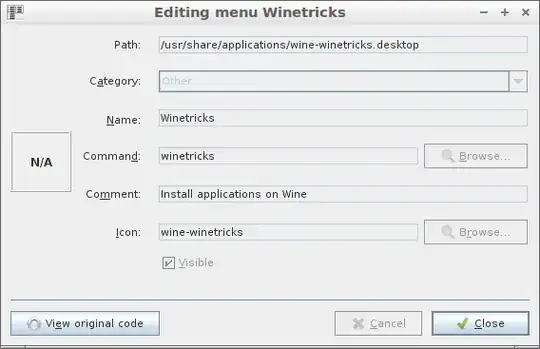

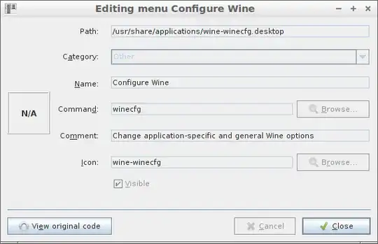

LXMenuEditor does not display Wine at all and it cannot create main categories anyway as Alacarte would (see this), and Wine was a such category.

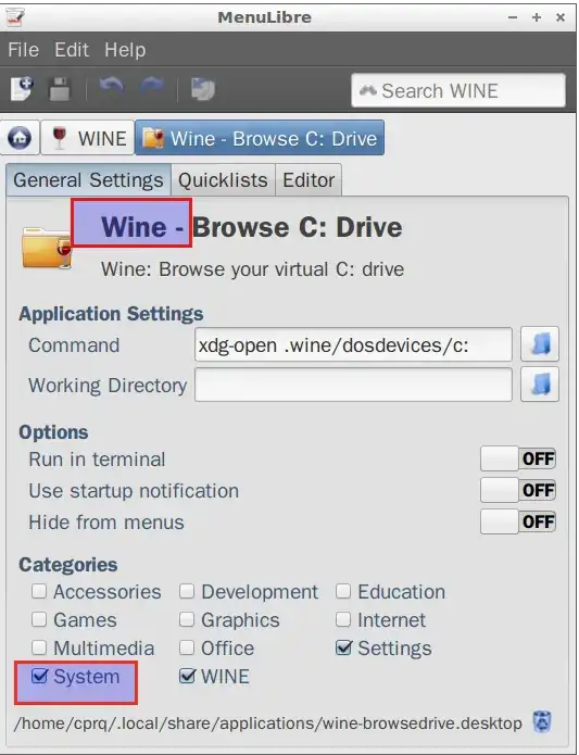

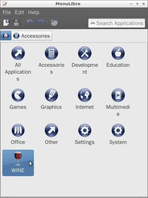

menulibre ("Menu Editor") displays Wine and its submenus.
But the Wine menu visibility cannot be edited in this app. The same problem of not being able to create main categories (as Alacarte would), but only items. That is, individual items can be created and set to appear in certain categories but there's no setting on these very categories.
