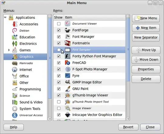

  2. I went to Main Menu -> Preferences -> Main Menu -> Games; alternatively, you can run Alacarte from the Terminal:
    alacarte
    Here an example of Alacarte interface:
  1. I selected New item
  2. Then I chose
    • the name of the new item,
    • the icon (by clicking on the empty icon and adding the path of the image I wanted to use as the new icon)
    • and the command line to be executed (I did not know all the exe commands of the new packages: so I opened the desktop config files stored in /home/user/.local/share/applications with Leafpad and copied the command line that follows the Exec= entry).
