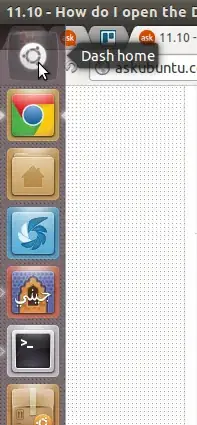

What you need to do is open the Unity Dash (it's the button with the Ubuntu logo on the upper left), and type Disk Utility.

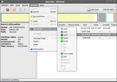

Gparted:
However, as Bruno pointed out, you need to install Gparted to actually create partitions with a GUI.
To do this, open the Software Center, search for Gparted, and click install. (Or click this icon: gparted Install gparted)

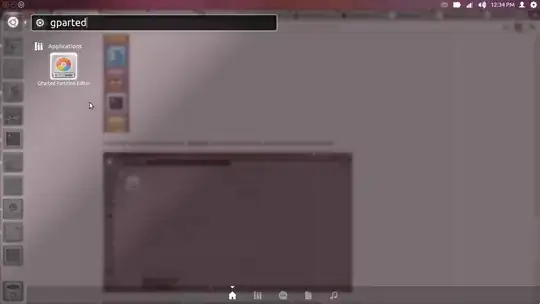

First make sure you have gparted installed. Now, in order to access software using the default Unity interface, either press the Meta key (Windows) or press the Ubuntu logo on the launcher.
From the Dash Home type gparted or Partition Editor until the GParted Partition Editor appears in the search results
From here you can either strike Enter or use your mouse to click the Partition Editor icon.

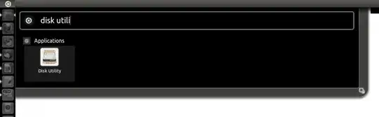

If you want to create partitions and move data around you can do that with several tools, the default installed tool Disk Utility can be called from the dash by pressing the super key and looking for Disk in the search box.
For a better utility that allows you to do more with your partitions I recommend gparted.

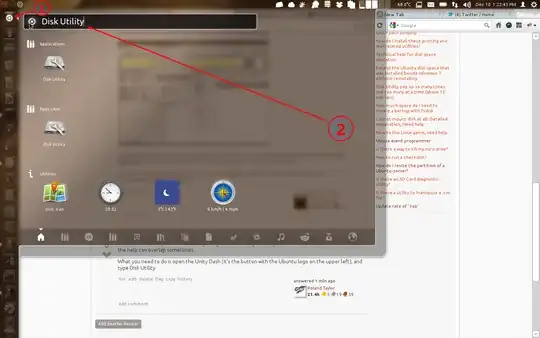

Press the Super (Windows) key to open the Unity Dash. Type disk. Now you will see the Disk Utility icon in the search results. Click that icon to open Disk Utility.
