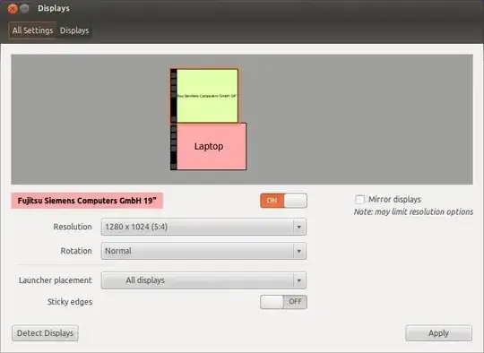

I use the Displays application to arrange the position of the monitors so it look like this:
Desired display configuration
The problem:
Whenever I restart my computer the configuration gets lost. First, the displays are mirrored instead of extended. I have to press Fn + F7 two times to switch to extended mode. Second, the Displays settings still look like this:
Diplay configuration after restart
