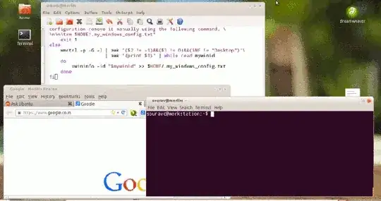

Hope it will solve your problem. Here is a screen shot,
