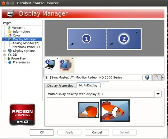

I have a HP DV7 with an ATI graphic card and I have a Samsung monitor connected to the laptop. Every time I turn on the laptop the displays are mirrored and I have to go to the Catalyst control centre (Administrative) and change the displays configuration, I have to do this EVERY TIME I turn on the computer.
I Didn’t try the solution suggested here ( Settings for multiple monitors are not stored ) because it took me a lot to make the graphics card work properly and I want to make sure that I have the right solution ( or the "rightest")
Thanks!

I had a similar problem which I solved quite easily. Although I've a different video card it might works for you.
I've set an .xprofile file in my home directory with the following content:
xrandr --output LVDS1 --mode 1366x768 --primary
xrandr --output VGA1 --mode 1280x1024 --left-of LVDS1
I think the lines are quite self explaining and you could easily modify it so that it fits your situation. A graphical way to setup your screens using XrandR is ArandR
The settings will be applied when you log in.
