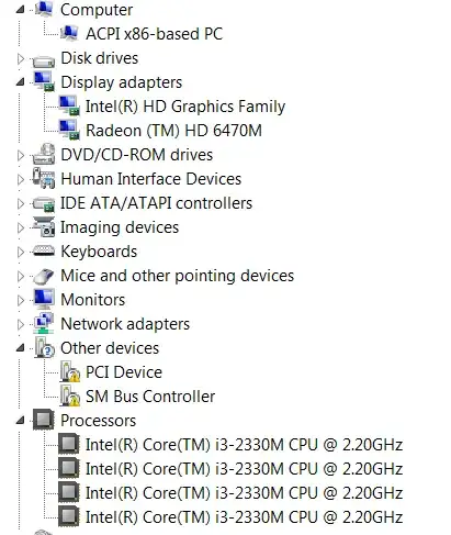

The Windows device manager displays:

It seems(from your image) that you have a Radeon graphics card... This may be the problem
