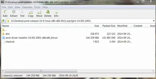

  2. Best install the latest AMD Catalyst driver. - I have found that on the AMD site. - Although sometimes the machine shuts down because of the heat before ending even the OS installation, if I get the chance I should install that, I think. In Windows, the package looks like so:
Would the installation start by double clicking the .run file?

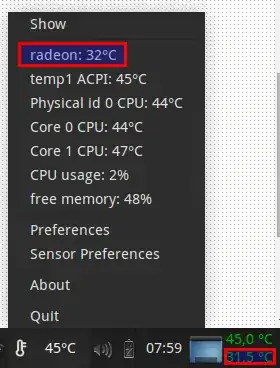

(The best way of monitoring GPU temperature in Xubuntu 14.04 when using the OpenSource driver.)
