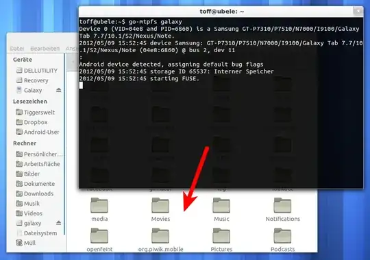

You could use go-mtpfs to mount your Android phone.
Install needed packages and get the source:
sudo apt-get install golang-go libmtp-dev
sudo go get github.com/hanwen/go-mtpfs
sudo ln /usr/lib/go/bin/go-mtpfs /usr/local/bin/
Add yourself to the group fuse (after that log out and log in again):
sudo adduser $USER fuse
Create a folder for your Android phone and mount it with go-mtpfs into that folder:
mkdir android
go-mtpfs android
Unmout your Android phone (wait for the end of file operations):
fusermount -u android
Source: https://linuxundich.de/de/android/mit-go-mtpfs-unter-linux-auf-android-handys-via-mtp-zugreifen/

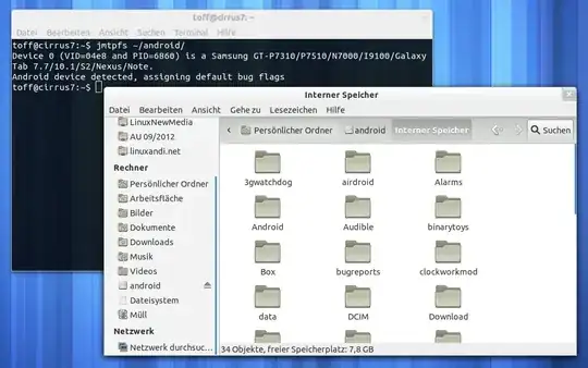

You could use jmtpfs to mount your Android phone.
Download jmtpfs, unpack and change into directory:
cd /tmp
wget http://research.jacquette.com/wp-content/uploads/2012/05/jmtpfs-0.4.tar.gz
tar -xzf jmtpfs-0.4.tar.gz
cd jmtpfs-0.4
Install needed packages, compile and install (for checkinstall questions hit enter) jmtpfs:
sudo apt-get install libmtp-dev libfuse-dev libmagic-dev checkinstall build-essential
./configure
make
sudo checkinstall
Create a folder for your Android phone and mount it with jmtpfs into that folder:
mkdir ~/android
jmtpfs ~/android/
fusermount -u ~/android

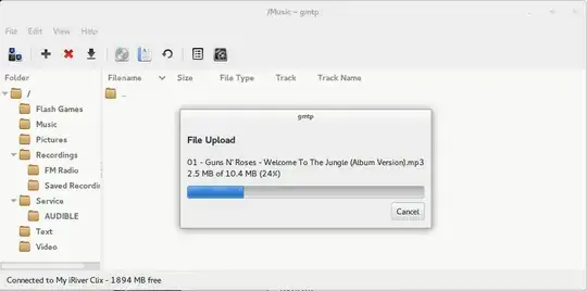

There's gMTP which is available in the app store, but chances are it won't work for your Galaxy S3 - it doesn't work on mine, most of the time. (You have to wait out the app hanging; it looks like it crashes whenever you interact with the app but if it recovers, then you know it works.)

gmtp provides a friendly UI to access new mobile devices and I've used it reliably for years.

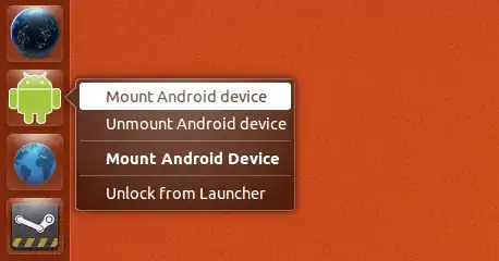

First install the launcher:
sudo apt-get install go-mtpfs-unity
Press the Ubuntu button on the unity launcher. Search for "Mount Android Device". And drag the icon to the unity bar.
Then simply right-click the icon and you should get this:
Enjoy your android device that now works perfectly on Ubuntu :D.

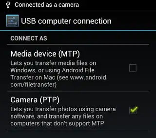

I have an LG P880 and I have created a directory inside "Pictures" and named it "ptp" then I connect my device as PTP, and copy files to pictures/ptp
There's one little problem though, I couldn't see a transfer dialog while copying files, so, I think you need to estimate time.. for me, I compress big files into little piece and wait for them to appear on the other side, then remove device after a while.
Then, of course, open any file manager and move/extract files to desired location. I use this method all the time..

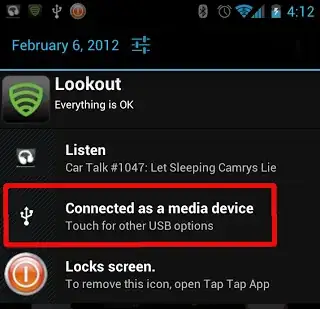

Is your Android device password protected and locked? I found I was getting the error:
Transport endpoint is not connected
because I hadn't entered the password. Once I authenticated on the device, I could connect.
Makes complete sense when you think about it. You shouldn't be able to just grab a device you don't have a password for and connect to it via computer.
