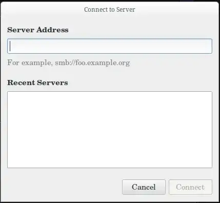

32
It is still there in "Files > Connect to ..."
Enter sftp://user@address/folder/ and you should be good to go.

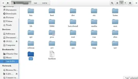

10
open terminal
ctrl + Alt + T
type:
nautilus-connect-server
Connect to server
Enter your ssh ip address:
ssh://youripaddress
Enter your username and password:
login
You are done: after successful login, you will see like this:
server folder
Hope this will help you.

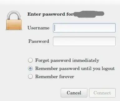

You can also enter:
ssh://IP address
For example:
ssh://192.168.1.4
The resulting dialogue box will ask for user name and password on the machine you are trying to connect to and give you options about how to remember the user name and password.

In newer versions of the Gnome file manager Nautilus (> Ubuntu 16.04), this feature has moved to a new location:
  • Open the file manager
  • Click Other Locations
  • At the bottom of the window you will see a connection dialog
Clicking the querstion mark will give examples on how to enter the server and what protocols are supported.
nautilus screenshot
