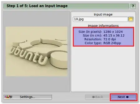

Install posterazor Install posterazor it will be suitable for you. After installation, you can see posterazor under Applications → Graphics → PosteRazor.
Using posterazor:

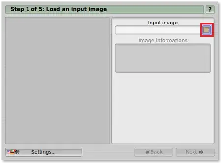

  • Step 1: Import your poster
    alt text
  • Step 2: You can see the size of the imported image here.

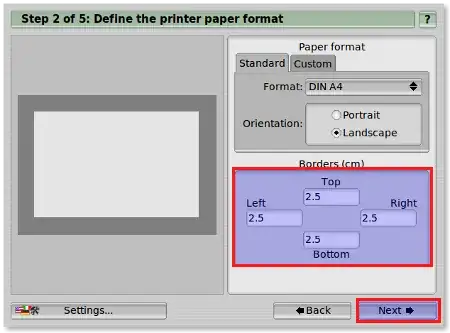

  • Step 3: Enter dimensions and borders alt text

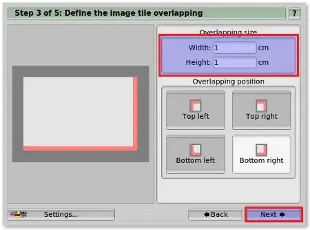

  • Step 4: Enter the overlapping value alt text

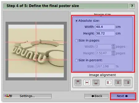

  • Step 5: Define the final poster size for multiple sheets.
    alt text

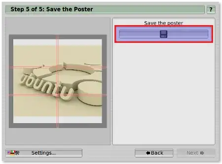

  • Step 6: Save the poster.
    alt text
  • Now you will get all the split images in PDF format.
  • Print the image and integrate it.

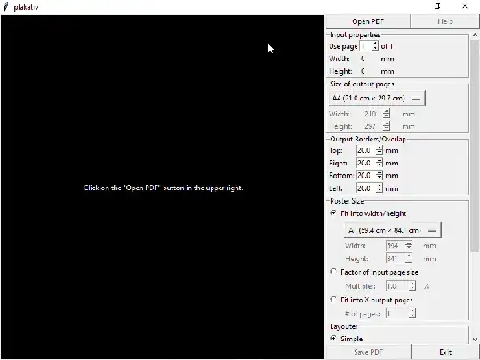

PosteRazor is great if your input is a raster graphic like a JPEG or PNG image. But in my case, my input was a PDF with lots of vector graphics. Since I was tired of first having to render them into a raster graphic so that PosteRazor could use them and since I didn't want the resulting quality loss either, I wrote a new tool called plakativ. You can grab it here:
https://pypi.org/project/plakativ/
If you are on Linux you can install it with pip. Windows executables are also regularly built on AppVeyor CI: https://ci.appveyor.com/project/josch/plakativ/build/artifacts
The source code is hosted here: https://gitlab.mister-muffin.de/josch/plakativ

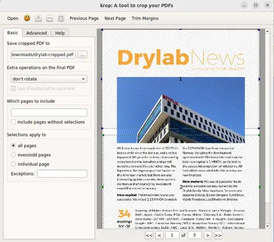

For multipage pdf you can use krop
Simply drag two squares with the mouse, then click the smiley. Krop will write a file in the same directory of an interlaced PDF of the original PDF.
