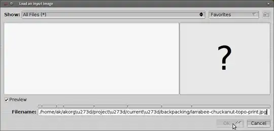

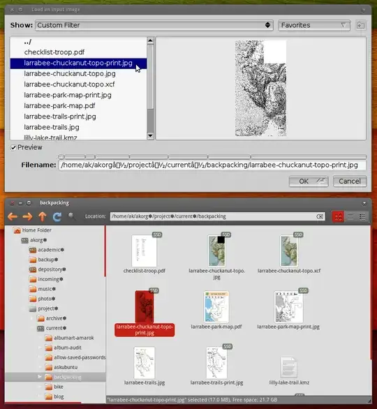

PosteRazor uses an apparently outdated GUI that is incapable of properly displaying my filenames:
PosteRazor - Load an input image
For the sake of convenience, I want to be able to open any file in PosteRazor by copying and pasting its path from Nautilus. This works in other applications, but sadly, PosteRazor is unable to understand the path:
How can I convert the path that Nautilus generates into a text encoding that is compatible with PosteRazor?

    • The same path as it natively appears in PosteRazor:
      The path <code>/home/ak/café/north-america.jpg</code> displayed in PosteRazor

    • PosteRazor after copying the path from Nautilus and pasting it into PosteRazor:
      PosteRazor with OK button grayed out
    • PosteRazor after copying the path from PosteRazor and pasting it into PosteRazor:
      PosteRazor with OK button active
