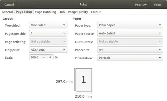

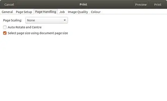

I have a feeling that if I use the right settings it should work. But for example, the following settings on Page Setup and on Page Handling: Print Page Setup Settings Print Page Handling Settings
When I click preview I see the full A3 sheet in one landscape page I still press print in the hope that it will do what I want but:
It prints only the top right corner in landscape which I do not understand the logic.
Following the comment: If the box labelled "select page size using document page size" under the Page Handling tab is un-ticked then I get half the job done: It will print only the left hand side in an A4 portrait which is what I want. But I will still be missing the right hand side.

No, you can't do that from the standard print dialog.
The option "Pages per side" in print dialog is useful to print many-to-one and not one-to-many. The former is to print using less sheets, whilst the opposite is to print posters (known as tiled printing).
But I see such option?
GTK+ has the option named "Pages per side". In other graphical toolkit or application however, such option may be found as "Number-up" (Qt) or "N-up printing" (Scribus). Not all application has this option, however.
Despite naming is different, the purpose is same: to adjust the number of "pages" to be printed on each "sheet".
  • "pages" refers to the content that is read by an application, usually from an existing file that has been created beforehand. This is what we have.
  • "sheet" refers to the content that will be printed via a hardware printer or, that will be saved to a new file. This is what we will get.
For simplicity, understand "pages" as the input and "sheets" as the output.

But I get half the job done?
Notice that "half the job done" is found at left side, regardless of paper orientation (Illustration 1a). This is due to the origin (0,0) is located at the left corner, similar to a display screen.

Therefore, the right half area will not appear because the option "Pages per side" is simply not intended to work as tiled printing. The left and right sides may be reversed (so far I have not seen this effect), due to the page handling or whatever combination of options being tried.

  3. One-to-many. By using only the option "Pages per side" in the print dialog, this is impossible.
Use case 1 is the most basic use. Certain options allow users to adjust the fit, when the page has different paper size or orientation. Hence a single large page A3 could be printed on a single smaller sheet A4 by scaling down the content.
Use case 2 is more likely used by students who want to print a handout that consists of 30 presentation slides. Instead of 30 sheets of paper, use 6 pages per side and the result is printed to only 5 sheets of paper. That saves 25 sheets or 80% less paper!
Use case 3 is not possible because there is no such option in the standard print dialog on Linux; so that "another half" is also not possible.
