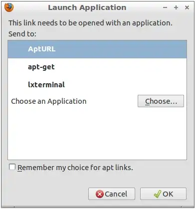

    • Set Firefox Preferences to "Always Ask" for apt
    • Click on a link, and select AptURL:

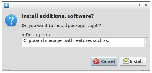

    • And the window will pop open:
    • Installation will take place using a lightweight gDebi-style frontend

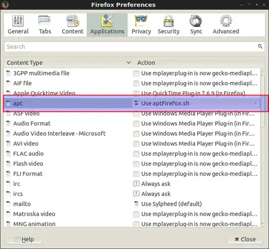

You can change the Action in Preferences > Applications from Ubuntu Software Center to this simple shell script.
#! /bin/bash
toInstall="$@"
toInstall=${toInstall#*:}
lxterm -e "sudo apt-get install $toInstall; read"
Save this to some file, say aptFirefox.sh, and make it executable by running:
chmod +x /path/to/aptFirefox.sh
Now you can replace Ubuntu Software Center with aptFirefox.sh.

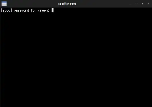

Now whenever you click on any apt link, it will show a terminal window asking for your password.
After you correctly enter your password, it will install the package.
