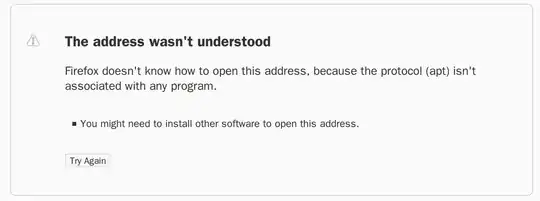

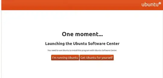

Many answers on Ask Ubuntu direct to links like this that in Xubuntu opened in Ubuntu Software Center. In Lubuntu I get this error message:

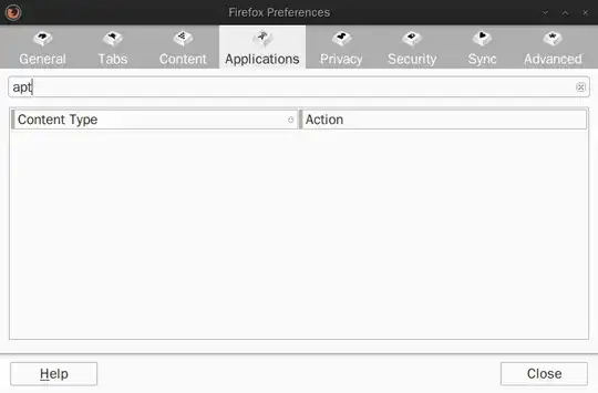

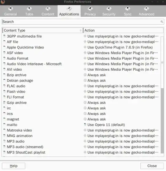

In Firefox-Preferences/Applications cannot see something resembling to apt to associate to a program etc.
Opening the same link in Chromium or Opera I get:
Clicking "I'm running Ubuntu" results in an error message like in Firefox.
What's the remedy? Can I install Ubuntu Software Center?

Point the select application to:
/usr/bin/apturl
This sould solve the problem.
Don't forget to check "Remember".

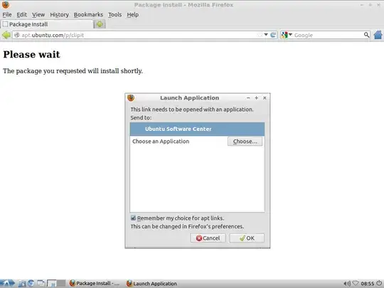

All you need to do is install the (Ubuntu) Software Center in Lubuntu.
Open a terminal, and type sudo apt-get install software-center. Then, the first time you click on a APT link in Firefox should give you the below popup, after which such links should open automatically:
Beside Ubuntu Software Center, a much lighter application (AptUrl) can be used to handle "apt://" protocol/links: see this answer to a related question.

The issue is solved after installing Ubuntu Software Center, which was not installed.

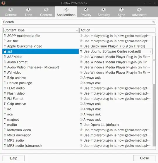

Now, after opening that link in Firefox, it offers the normal option to open that link in Ubuntu Software Center, and to remember that option. Also, following this, apt appears in the list from Firefox' Preferences/Applications:
Preferences/Applications Screenshot
