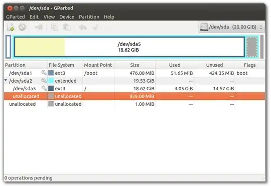

  • Here, I deleted the my /dev/sda6 swap partition in the highlighted space:

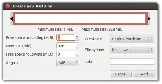

  • Right-click on that unallocated space, and click on New; choose type "linux-swap", click on Add:

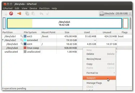

  • Right-click on the new swap partition and choose "swapon":
