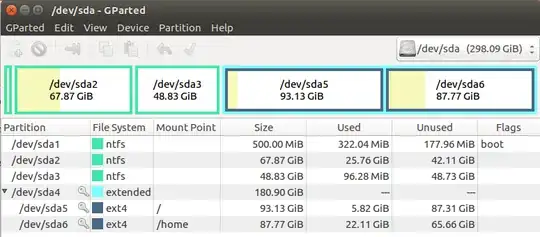

this is my disks partitions
These are my partitions. I have dual boot with windows 10 and Ubuntu 16.04 LTS. I installed Ubuntu without creating a swap partition. I have only root (/) and /home partitions. I want a swap partition for Ubuntu to run smooth. How do I do it?.

  1. Boot from Ubuntu LiveCD
  2. Open GParted
  3. Resize /(root) partition
  4. Use freespace after root partition to create swap partition.

As suggested by CelticWarrior, your image shows /dev/sda5 as a good choice for making space to create your swap partition. You didn't mention how much ram you have. But you might consider (if you can spare the disk space) making your swap partition at least as big as your ram size.
You can add the partition using the link provided by Katu Txakurra (How do I add a swap partition after system installation?).
Add it to your /etc/fstab (details in the link). After you have made the fstab entry you can activate or check it without booting it with this command:
$ sudo swapon -a
If you get errors you might have to check your /etc/fstab entry. You can also check to see if it's available with the free command. If you see zero available (the first column) for swap then you'll have to recheck your etc/fstab entry.
$ free
              total        used        free      shared  buff/cache   available
Mem:        7616296      800840     5892464      112036      922992     6401352
Swap:       8191996      776752     7415244
