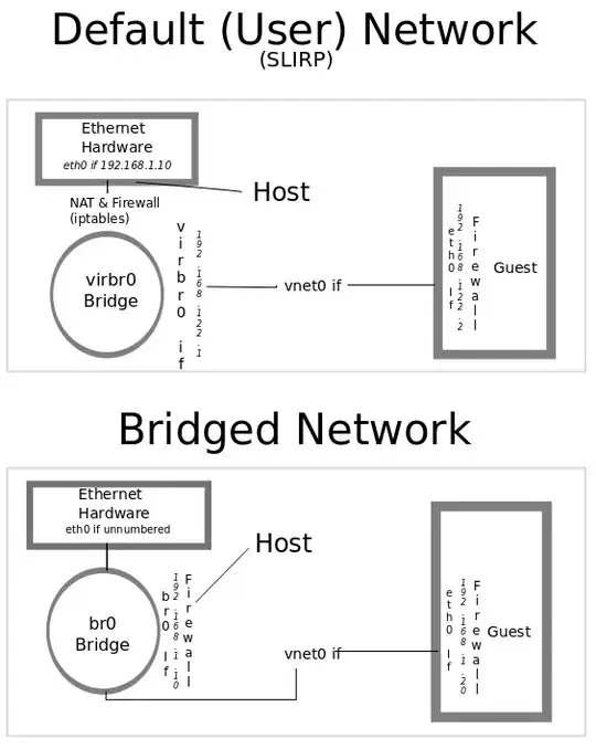

Network Setup
The default network mode is the User mode, also called SLIRP. It uses a predefined virbr0 bridge which is NAT routed to the guest computer. The NAT routing uses the kernel's ip_forwarding feature and iptables. Bridge mode uses a virtual bridge in the guest to which the (unnumbered) Ethernet interface connects, and on which both the host and the guest have their network interfaces.
The following diagrams may make the differences clearer:
Network diagrams
You can see how the default User network is defined with:
virsh net-dumpxml default
I can set up the bridged mode with the following approaches:

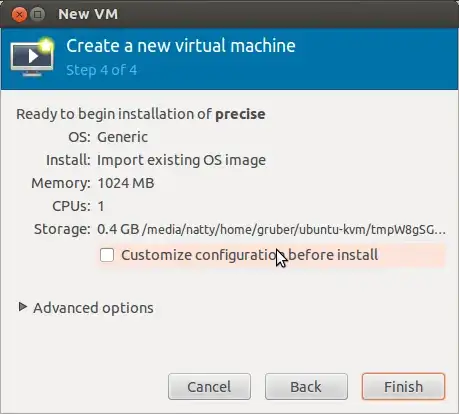

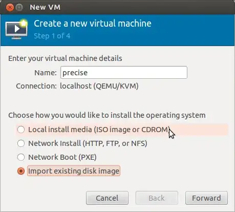

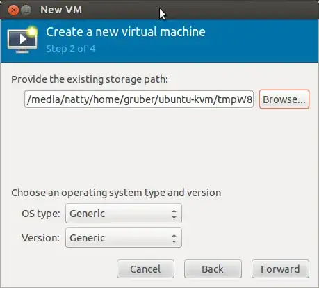

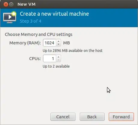

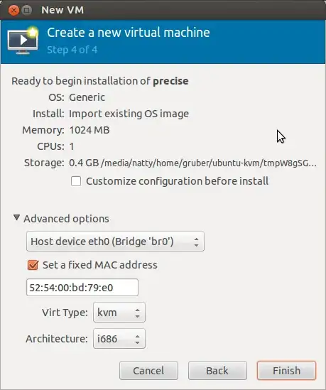

virt-manager
Be sure that you have installed virt-manager and hal. The hal package is a suggested dependency for virt-manager and is used to determine the network configuration of your system when creating or editing guests.
While having the br0 bridge defined as above I created a virtual machine with virt-manager as follows:
enter image description here enter image description here enter image description here enter image description here enter image description here
I was able to go directly to the rest of my home network and to the Internet from this guest. I was also able to ssh into it from the other (non-host, non-guest) Ubuntu computer on my home network.

Then, create the tun-tap interface and bridge it with your default interface (usually the one with an Internet connection).
Script create-qemu-bridged-tuntap.sh:
#!/bin/bash
bridgename=br0
tapinterface=tap0
outinterface=eth1
if [ "x$1" != "x" ] ; then
    outinterface="$1"
fi
ifaces=`awk -F: '{print $1}' /proc/net/dev | tail -n +3`
iffound="0"
for i in $ifaces
do
    if [ "$outinterface" == "$i" ] ; then
            iffound="1"
    fi
done
if [ "$iffound" == "0" ] ; then
    echo
    echo "Can't find the output interface."
    echo
    exit 1
fi
outifaceip=`ifconfig | grep -A1 $outinterface | tail -1 | awk -F: '{print $2}' | awk '{print $1}'`
outifaceiptokens=`echo $outifaceip | awk -F \. '{print NF}'`
if [ "$outifaceiptokens" != "4" ] ;  then
    echo
    echo "The selected output interface $outinterface doesn't seem to have a valid IP address."
    echo
    exit 1
fi
hostaddress="192.168.1.1"
guestaddress="192.168.1.95"
sudo tunctl -t $tapinterface
sudo brctl addbr $bridgename
sudo brctl addif $bridgename $tapinterface
sudo ip link set $bridgename up
sudo ip addr add $hostaddress/24 dev $bridgename
sudo route add -host $guestaddress dev $bridgename
sudo parprouted eth1 $bridgename
sudo ~/scripts/ip-router.sh $outinterface
I use these scripts daily, so they should work well also for you. You'll have to install some package in order to have all of this working. Using:
dlocate `which COMMAND`
you can see which package is required to have COMMAND. For example to see which package is required to have brctl, simply run:
dlocate `which brctl`
and you'll have:
bridge-utils: /sbin/brctl
Using the same approach for all the commands in these scripts, you should (at least) run this aptitude command line:
sudo aptitude install dlocate iproute parprouted iptables uml-utilities bridge-utils net-tools
Finally, you can launch the main script (as a normal user):
#> create-qemu-bridged-tuntap.sh eth0
Set 'tap0' persistent and owned by uid 0
Enabling IP forward and setting up masquerade NAT on interface eth0
Running ip addr you should see a br0 interface with IP address 192.168.1.1, as specified inside the create-qemu-bridged-tuntap.sh script:
#> ip addr
8: br0: <NO-CARRIER,BROADCAST,MULTICAST,UP> mtu 1500 qdisc noqueue state DOWN
    link/ether 36:76:ee:d6:63:b2 brd ff:ff:ff:ff:ff:ff
    inet 192.168.1.1/24 scope global br0
This is the host address as seen by the guest. Conversely, the guest will have as IP address 192.168.1.95 (again, this can be easily changed inside the main script).
Now, using virt-manager, you just have to setup your guest nic to use br0 as physical interface.
virt-manager-br0-nic
Inside the guest, you just have to give to eth0 an IP address of 192.168.1.95 and everything should run fine.
