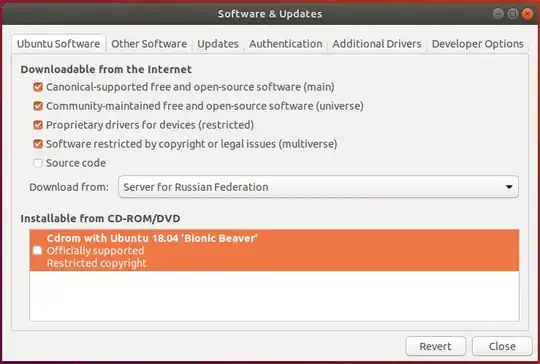

  2. then in the area named Installable from CD-ROM/DVD uncheck the Cdrom with Ubuntu 18.04 (Bionic Beaver).
    Software & Updates - disable CDROM

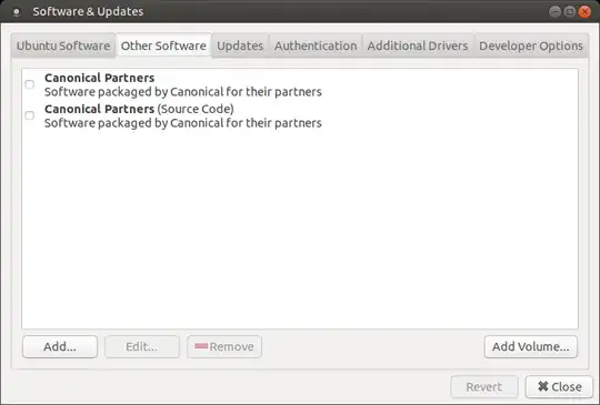

  3. make sure that you do not have checked Cdrom with Ubuntu 18.04 'Bionic Beaver' on Other Software tab:
    Software & Updates - other software

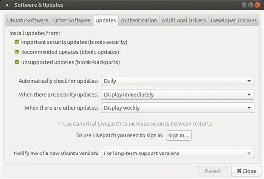

  4. to keep your system secure on Updates tab enable security updates (bionic-security, bionic-updates, bionic-backports):
    Software & Updates - updates
