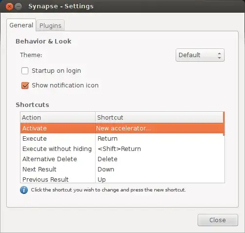

When I try to edit the synapse config it does not allow me to use the left Super as a shortcut to invoke it. Is there a round-about way that I can go through.
Synapse Configuration
When I just press the Windows/Super key the configuration window does not acknowledge it. However, a combination shortcut (such as Super+A) does work fine.
Since I'm using Precise, with Unity, I'd also need a way to change the default dash behaviour for Windows/Super key to something else.
