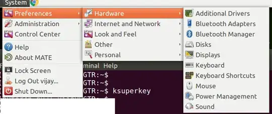

Except, I'm on Ubuntu 16.04 + MATE, so what I did was:
a) Removed Alt+F1 as the shortcut for the MATE menu in Preferences --> Hardware --> Keyboard Shortcuts
b) Set Alt+F1 as the Synapse shortcut:
cat ~/.config/synapse/config.json       {
          "ui" : {
            "global" : {
              "ui-type" : "default"
            "shortcuts" : {
              "activate" : "<Alt>F1"
c) Installed and ran ksuperkey
ksuperkey now does the mapping from the release of the Win key (Super key) to Alt+F1, which triggers MATE to launch Synapse. At the same time, other combinations involving Win work fine without invoking Synapse. (In particular, I set up Win + M to minimize all windows and show the Desktop and that's important to me).
Note that ksuperkey is quite flexible and the can map the release of any key to send any key combination, not just Alt+F1 (the default).
d) Added ksuperkey to Startup Applications
