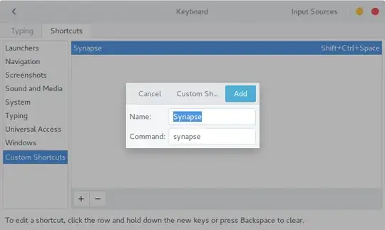

I installed in Ubuntu 16.04.3, by the time I install ubuntu already had the ppa, so I simply installed by
sudo apt-get install synapse
The default shortcut was ctrl + space, only flaw was, settings (synapse) did not work.
Since I was using ctrl + space for some other purpose, I wanted to change it to alt + ctrl + space. I simply fixed it with a custom keyboard shortcut.
Go to custom shortcuts Setting -> Keyboard -> Shortcuts -> Custom Shortcuts. Click on +, give a name (Synapse) and command (synapse), then Add. That's it now you I can use my custom shortcut.
