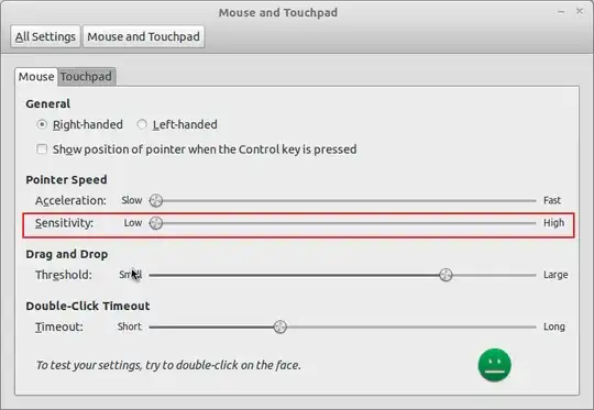

For Unity
  • Press Super key (windows key).
  • Search for mouse.
  • Select Mouse And Touchpad
  • Now change the sensitivity to higher value. Possibly this is what you want.
    mouse settings
