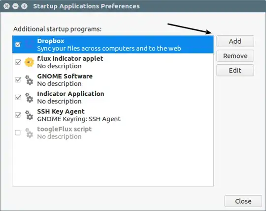

Press Alt + F2, type gnome-session-properties to launch startup application. Press Add to create new startup:
You should all set now.
