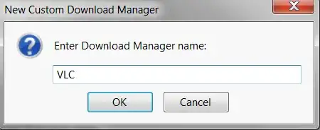

A cross-platform solution that is not limited to youtube is to use the well-known Firefox addon FlashGot, which is meant to send video streams to different download managers, but make it to send the URL stream to VLC (or mpv, which I prefer lately):
  • add VLC to Flashgot list: FlashGot options, General tab, Add, give a name 'VLC' , - then go to the VLC executable and select it
  • FlashGot options, FlashGot tab, choose VLC
  • playing the video in Firefox, a Flashgot button should appear (add that to the toolbar or the status bar). Right-click the button, Available formats, and left-click the video. VLC should start playing the video stream

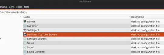

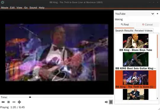

It starts the separate application, SMPlayer Youtube Browser, to search for videos. One can create a link/desktop launcher to it, enter image description here
or just run
smtube

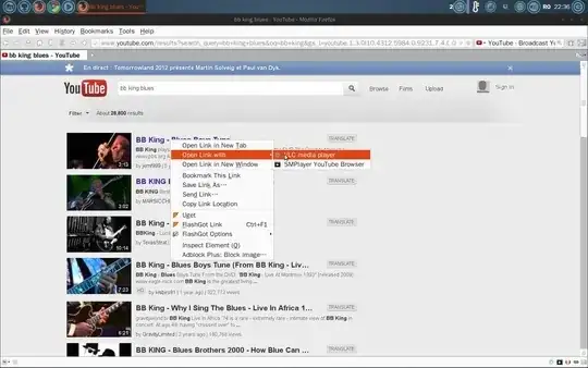

But I think that a more elegant method is using add-ons/extensions to open the external players directly from the internet browser's interface or context menu, like the aforementioned Flashgot addon.

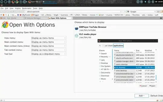

The re is also the Firefox Openwith addon, created initially to open links in different web browsers, can do just that, by adding in its Preferences vlc and smtube instead of/beside browsers .

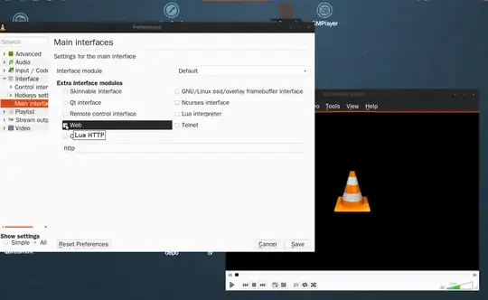

To use it, the youtube video has to be playing, the VLC web interface has to be enabled (VLC Tools-Preferences-Show Settings -All-Interface-Main-enable Web, restart VLC) and VLC has to be already open. enter image description here
