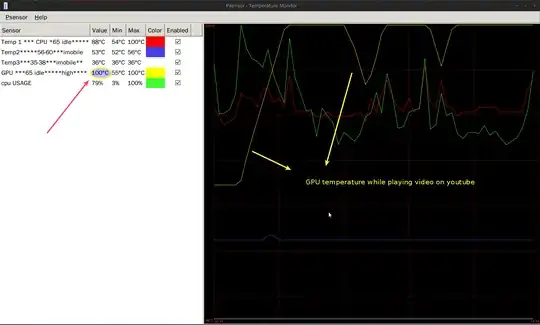

From my experience it is precisely the 'simple youtube clip' that puts graphic card to biggest stress as far as Flash is concerned (you have to look in something like psensor, to have a loud fan or a crashing computer in order to realize how heavy this stuff really is on the GPU).
The most recommended alternatives to Adobe Flash (like Gnash) are not yet up to the task, a fact that anybody will notice after trying those.
But for seeing youtube videos without spiking GPU temperature up to the ceiling one can use smplayer (F11 or edit main toolbar and add the specific button). Thus I was able to avoid the habitual 'flash experience' of putting my GPU to 100 degrees Celsius.
