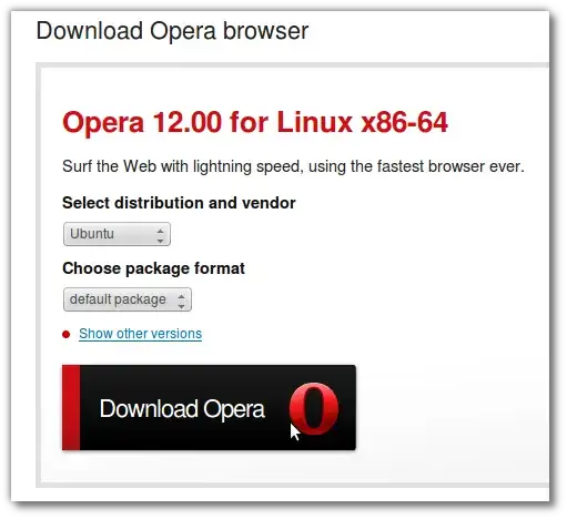

  1. To install Opera, simply go to their download page here. Ubuntu will be auto-detected, and click on the big Download Opera button:

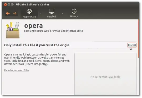

  2. Choose the "Open With" option, and the file will automatically open in Software Center once downloaded:
  1. Click on Install in Software Center, enter your password if asked, and then Opera will be installed:
