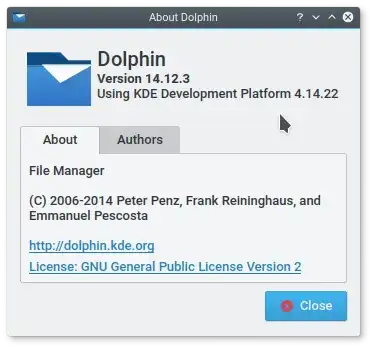

KDE4
The KDE4 based applications are using environment variables - KDEHOME:
KDE System Administration/Environment Variables information here and here.
If not set, KDE uses ~/.kde as directory where your personal data is stored.
Dolphin, KDE file manager, build with the KDE4 libraries. Configuration files are saved to the $KDEHOME/share/config/ ,if set, otherwise to the ~/.kde/share/config/

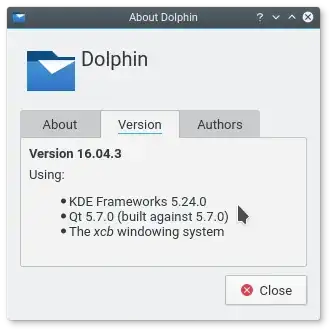

KF5 (KDE Frameworks 5)
The KF5 based applications are following the Freedesktop.org standards and specifications.
XDG Base Directory Specification here.
$XDG_DATA_HOME defines the base directory relative to which user specific data files should be stored. If $XDG_DATA_HOME is either not set or empty, a default equal to $HOME/.local/share should be used.
$XDG_CONFIG_HOME defines the base directory relative to which user specific configuration files should be stored. If $XDG_CONFIG_HOME is either not set or empty, a default equal to $HOME/.config should be used.
Dolphin, KDE file manager, build with the KF5. Configuration files are saved to the $XDG_CONFIG_HOME ,if set, otherwise to the ~/.config
