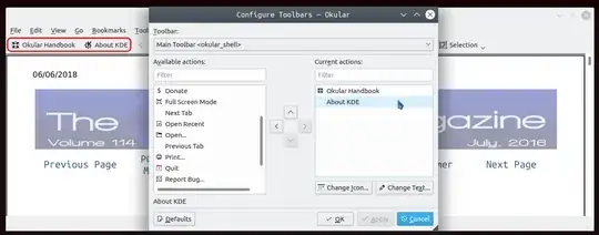

Here's an image of the toolbar I have before adding a couple of buttons:
before
I then used the GUI found in Settings > Configure Toolbars to add a couple of buttons (outlined in red) as seen below:
after
I found that these changes were recorded in ~/.local/share/kxmlgui5/okular/shell.rc, in Kubuntu 18.04.
On running diff on shell.rc before and after the changes I get:
$ diff 0shell.rc 1shell.rc
24a25
>   <Separator weakSeparator="1"/>
58a60,61
>   <Action name="help_contents"/>
>   <Action name="help_about_kde"/>
Of course, the line numbers maybe different on your system.
You've mentioned that copying the entire home folder doesn't help and I would assume that ~/.local/share/kxmlgui5/okular/shell.rc would be copied as well in which case you should have been able to carry over the changes. It's possible that something else is required but I don't know what that would be.
Edit: I just installed okular on Lubuntu 18.04. The same file, ~/.local/share/kxmlgui5/okular/shell.rc, exists there as well.
