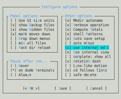

Press the following keys in order, one at a time:
  1. F9 or Alt + 9 Activates the top menu.
  2. o Selects the Option menu.
  3. c Opens the configuration dialog.
  4. i Toggles the use internal edit option.
  5. s Saves your preferences.
screenshot
