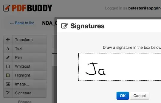

You could use PDF Buddy, an online PDF editor that makes adding signatures ridiculously easy: you can just draw them or add them as image files.
(Disclosure: I'm a co-founder of PDF Buddy)

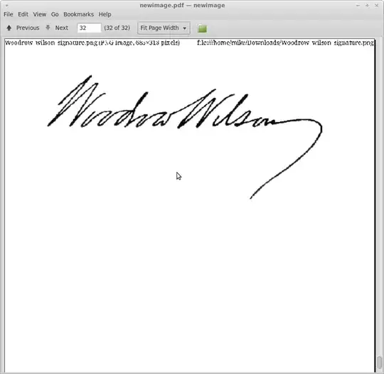

I have found a way to do this, but it involves converting your signature image to pdf and then merging that with the target application form and then outputting a new document; the signature is added at the end of the document. It is quite simple to do and may be the easiest way to do it. Imagemagick is the program to install (if necessary) and use its convert function in this manner: convert original.pdf signature.pdf final.pdf.
Screenshot

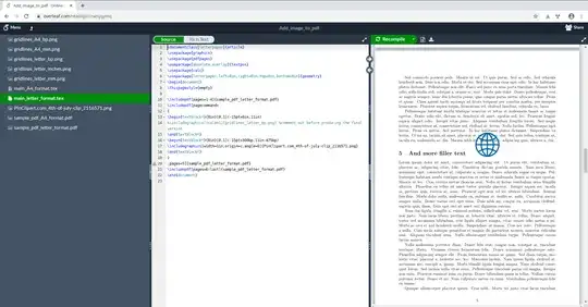

Once you click on that link, you should be seeing the Overleaf workspace, like this:
On the left you can see a bunch of files. One of them should be highlighted. Make sure that it is 'main_letter_format.tex' (click on it if it is not). Once that file is highlighted, its contents should appear in the middle part of the screen. On the right part of the screen, you should see a nicely formatted document with the title 'A sample pdf document'; if you do not, press the button 'Recompile' that's above this part of the screen. In the end, the page should look like the above screencap.
On the right side of the screen, scroll the document down to page 5. You should see this:
The blue globe,
enter image description here,
is the png that is superimposed on the pdf.
You can download the whole output pdf (with the png added to it) by clicking on the following icon, to the right of the 'Recompile' button:

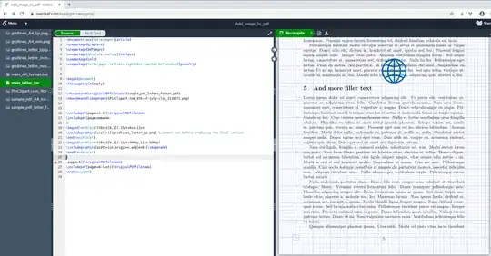

Note that line 20 is 'commented out' by starting it with '%':
%\includegraphics[scale=1]{gridlines_letter_bp.png} %comment out before producing the final version
If you remove the initial '%' and recompile, you will see grid lines on page 5. (To be able to actually remove the initial '%', you need to be logged into your own Overleaf account and do it in your own copy of this file.) Such grid lines may be helpful to position the image on the page. This is what they look like:
At present, the spacing of the grid lines is in units of 'bp', which are PostScript points (1/72 of an inch). I have also produced (see below for an explanation of how) grid line files with spacing in inches ('gridlines_letter_in.png') and millimeters ('gridlines_letter_mm.png'). For A4 format, I produced grid line files with spacings in bp and in millimeters. If you prefer some of these other grid lines, just substitute their respective file names in line 20. But make sure to again comment out line 20 (and recompile) before you download the final document, so that the grid lines do not appear in it.

If you look at the screenshot with grid lines (above), you will see that the png containing the 'blue globe' is 72 bp ( = 1 in) wide, extending from 300 bp to 372 bp. The width is specified in width=1in in line 23, and the height is scaled so that the aspect ratio is the same as in the original image. Alternatively, you could provide the height (height=1in), and then the width will be scaled. You can also provide both width and height (generally, this will distort the image, but sometimes that is useful). Another way to resize the image is by using the command 'scale='; for example, 'scale=0.1' makes the image size 10% of its original size. Finally, one can rotate the image by specifying angle in degrees (the rotation is about the center of the image). For even more details, see here.
That takes care of the size and rotation of the image. Its placement on the page is done in line 22:

\end{textblock*}
,pages=5]{\originalPDFfilename}
\includepdf[pages=6-last]{\originalPDFfilename}
\end{document}
The grid lines were produced using this code (which I found here):
\documentclass[letterpaper]{article}
\usepackage{xcolor}
\usepackage[grid, gridunit=bp, gridcolor=blue!40, subgridcolor=blue!20]{eso-pic}
\begin{document}
\thispagestyle{empty}
\mbox{} %need to have *something* on a page to render it, so we put an empty box of zero width
\end{document}
Once the pdf with the grid lines is produced, you should convert it to a png image file with white replaced by transparency. This can be done using the free program GIMP (GNU Image Manipulation Program):
  1. Open the pdf page containing the grid lines in GIMP. You can right-click on it and select 'Open With', and then click on 'GNU Image Manipulation Program'.
  2. You will be prompted to import pdf. Click the 'Import' button.
  3. Make sure there is a transparent layer: Layer->Transparency->Add Alpha Channel. In fact, 'Add Alpha Channel' should be greyed out, which means that the alpha channel (i.e. the transparent layer) is already present. If so, exit this dialog by clicking anywhere else on the screen. If 'Add Alpha Channel' is not greyed out, click on it.
  4. Colors->Color to Alpha… . In the new window dialog, make sure the 'Color' field is set to white, that the 'Transparency threshold' is 0, and that the 'Opacity threshold' is 1. If so, click 'OK'.
  5. File->Export As… . Make sure you change the extension of the name to '.png'. Click 'Export' button. A new dialog window will appear; click 'Export' in that window, too.

I've also been looking for a way to insert an image of my signature to a PDF. Funny how complicated this is. Many of the free tools out there let you insert a water mark, but you need to give x,y coordinate for where it goes, in other words "no gui." fine for a water mark, no good for a signature that needs to land on a line.
I just discovered PDF escape http://www.pdfescape.com/ which worked like a charm. online gui, let me easily upload a PDF and an image, and place/scale it as I needed.
