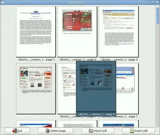

PDF Arranger formerly known as PDF-Shuffler.
If you want a tool with a simple GUI, try pdfarranger. It allows for merging of PDFs as well as rearranging and deleting pages. For batch processing and/or more complicated tasks, pdftk is of course more powerful.
Screenshot of PDF-Shuffler
To install PDF Arranger in Ubuntu 20.04 and later open the terminal and type:
sudo apt install pdfarranger
