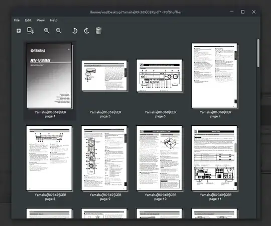

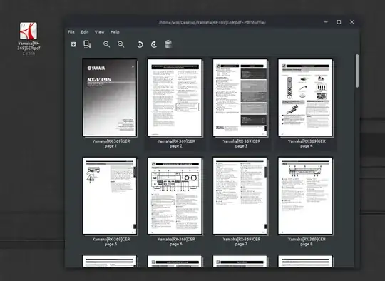

In OSX's Preview.app the build in "crop-function" would be the best choice to delete unwanted user defined parts of a single page. Alternatively you could select one or more pages and delete them all together.
In Ubuntu there are similar applications that offer these options as well: I use and prefer PDF-Shuffler for PDF Merging, Rearranging, Splitting, Rotating and Cropping.
  1. Simply install by using Ubuntu Software Center
  2. Open your pdf-file of choice, select your unwanted pages and delete them and/or use the "edit -> crop-option".
  3. Save your modified pdf-file.
I deleted Page2/3/4 and cropped approx. 50% of Page 5/6 for a visual example in a few seconds.
