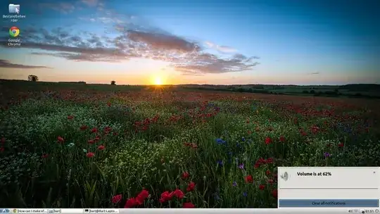

I'm using Lubuntu 12.04, with xfce4-volumed installed, see this question. When I'm changing the volume using FN+Vol-, a nice notification balloon pops up. This is what I want. However, when I try to change the volume 10 seconds later, I first have to click the 'Clear all notifications' button to get further notifications. I want to get rid of this: xfce4-volumed should always be giving notifications, whether or not I've clicked the button.
How can I get this done?
Answers that tell me how to disable the whole envelope thing, or change it by another notification daemon to get this done, are also welcome.

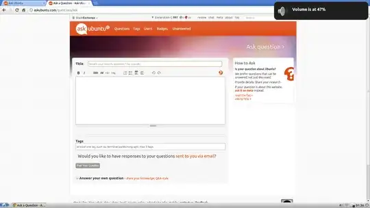

This is what I want to happen: the balloon indicating the volume as I change it This is what annoys me: I first have to click the button to get further notifications
