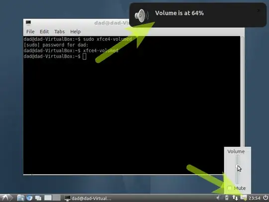

You'll need some prerequisite packages:
sudo apt-get install xfce4-volumed gstreamer0.10-alsa
xfce4-volumed is a daemon that requires the gstreamer-alsa plugin to work. Normally you would have this run on startup.
However, for testing I just ran xfce4-volumed from a lxterminal.
If you then use the standard volume control you'll see the popups - you'll also need to clear the notification envelope in the system tray to see further popups.
In testing though - I found that xfce4-volumed was quite temperamental - sometimes it stopped working and the only way to get it to start again was to logout and login :(
