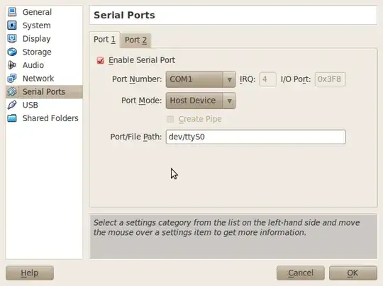

Setting up a serial port for VirtualBox is not easy, mainly because of many options on how to transfer data from the host to the guest. For transferring data from/to an attached device (here a modem) the following settings should work:
alt text
Of course you will have to adopt setting for your device on the host (that would be /dev/ttyS2 in your case).

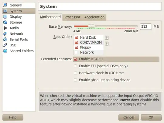

If using an IRQ greater than 15 for the host you will have to enable I/O APCI as shown here:
alt text
After a setup depicted in the example here your Windows guest will see a virtual type 16450 serial port on COM1 using IRQ4 and I/O Port 0x3F8. Data will be transferred from and to host device /dev/ttyS20.
