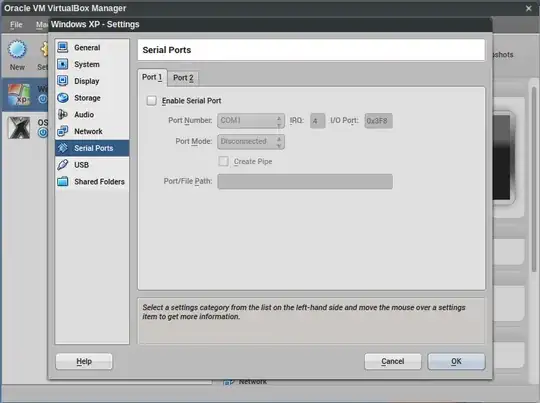

Not sure about VirtualBox OSE, but if you don't have the serial port options in the settings, then grab the proprietary edition of VirtualBox here.
In the virtual machine settings, you should be able to enable up to two serial ports: enter image description here
