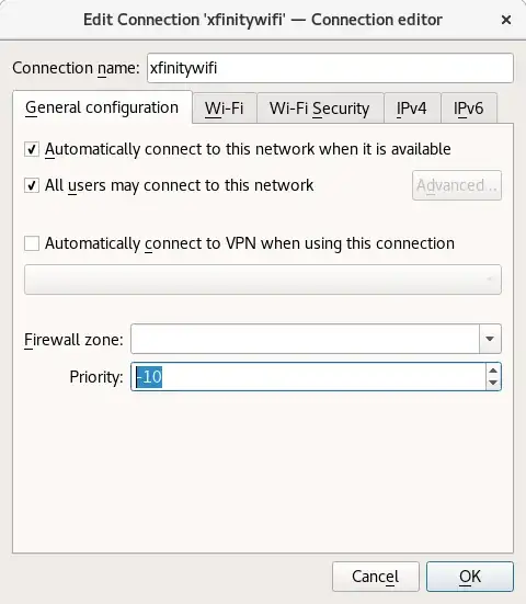

How to use plasma-nm
Plasma-nm, KDE's NetworkManager client, lets you change a network's priority through several clicks in a graphical interface. You cannot drag-and-drop, instead you must specify a number. As with nmcli, higher numbers are higher priority. Unfortunately, you cannot see a list of what other priorities you've set in the past so you may have to guess at a number. Personally, I just use "10" for preferred networks and "-10" for last resort networks and I don't differentiate between them beyond that.
You don't need to install all of KDE just to get plasma-nm. (On my machine, running GNOME, the full KDE package would have required downloading over 600MB; in contrast, plasma-nm was only 8MB). I installed plasma-nm from the command line like so:
sudo apt install plasma-nm
and I ran it by typing this:
kde5-nm-connection-editor
(Well, technically, I didn't type all that. I used TAB to autocomplete the typing for me).
If you don't use KDE, the first time you run plasma-nm, it will ask you about creating a "wallet" to store credentials. I just hit "Cancel" to the question and it worked fine for me.
Then it will show you a list of connections. Double-click on the connection you want to edit. That will bring up the "Connection Editor" panel. Choose the "General Configuration" tab. At the bottom, you'll see a box labeled "Priority". Change it from 0 to 10 (preferred) or -10 (last resort). Click "OK" to save the changes.
Connection Editor panel of plasma-nm
Since changes are permanently stored with NetworkManager, once you're finished adjusting priorities, you don't have to keep plasma-nm installed if you don't want to. (sudo apt remove plasma-nm)

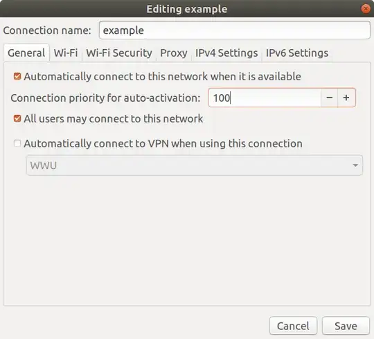

If you are using xfce, for instance under xubuntu 18.04, you can do this:
  • Go to the Wifi applet (upper right corner)
  • Click "Edit Connections"
  • Double-click the network of interest
  • Click on the "General" tab
  • Enter a value for "connection priority for auto-activation"
Positive numbers are higher priority; negative numbers are lower priority. The default priority seems to be 0, so I set the priority of the ubiquitous but not always working "xfinitywifi" to a negative number so that anything else connects first.

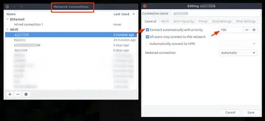

I carry around a mobile Wifi device (4G) and also use the mobile hotspot from my mobile (4G but different provider). When I'm at home or work I usually use the Wifi available there. But when things are slow I sometimes need to switch wifi to the mobile devices. Here's what I did to make it faster.
Set the priorities
  1. I ran nm-connection-editor from the terminal. That opens the 'Network Connections' application where you can set the priorities for the different Wifi access point you use.
  1. I changed the priorities so that the mobile Wifi devices are higher up in the order.
    • Mobile hotspot -> 100
    • Mobile Wifi device -> 90
    • Office Wifi -> 50
    • Home Wifi -> 40 , etc

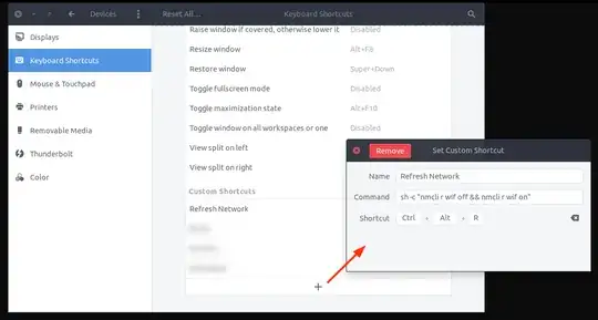

  2. Now when I'm in office it's usually connected to Office Wifi, if it doesn't detected the mobile ones at startup. However in case I feel the Office network is slow and wish to connect to a mobile wifi, I simply run a shortcut (Ctrl+Alt+R) key with the below command:
    sh -c "nmcli r wifi off && nmcli r wifi on"
Create a shortcut key
  1. Open Settings > Devices > Keyboard Shortcuts
  2. Scroll down and click the plus (+) button at the bottom to add a new shortcut
  3. Give it a name, key combination (Ctrl+Alt+R in my case) and enter the below code in the Command field:
This is a combination of two commands - first part turns off the wifi and the second part turns it back on. When it does this it connects you to the Wifi access point with the highest priority available.
  1. Save and you're done.
Now whenever you want to connect to a Wifi access point with a higher priority simply use the keyboard shortcut. Saves 5-6 clicks every time!

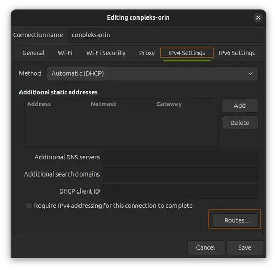

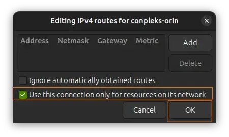

Case

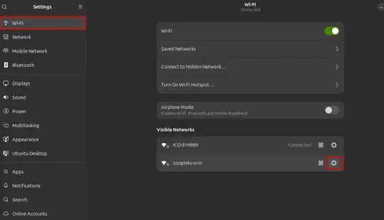

Your pc is connected to a WiFi access point that does not reach the internet. Your pc is also connected to ethernet or LTE/4G modem.
Solution
Updated with simpler solution
  1. Click the gear icon on the wifi network enter image description here
  2. Set the check-box in IPv4 settings. enter image description here
Original solution

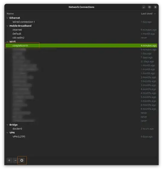

You can configure an access point to be de-prioritized so your pc will connect to the internet with ethernet or LTE.
  1. Bash: nm-connection-editor
  2. Select the wifi accesspoint you wish to deprioritized enter image description here

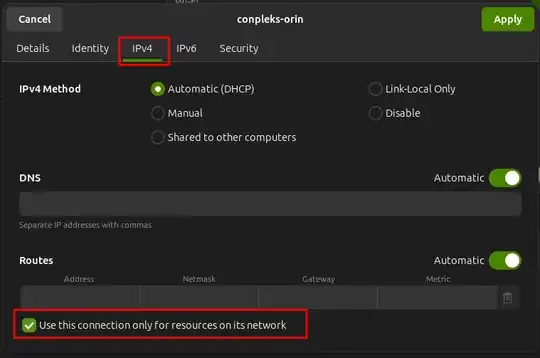

  3. Select IPv4 -> Routes... enter image description here
  4. Enable "use this connection only...". Mouse-over tooltip: "If enabled, this connection will never be used as the default internet connection" enter image description here
