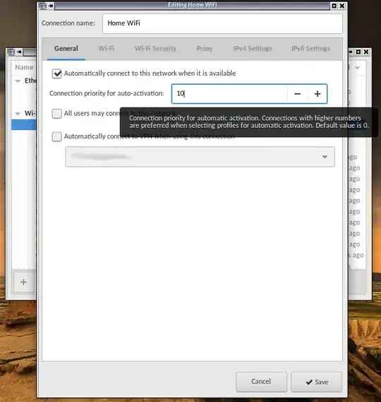

This is now available in Gnome Network Manager (nm-connection-editor) in the General section. Give the connection priority for auto-activation a higher value on your preferred network.
https://i.sstatic.net/QQK0W.png
